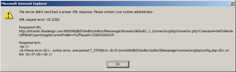

"XML request error (200) server didn't send back proper response" is an error message dialog box I get when trying to use the newly integrated wysiwyg editor in my tikiwiki 1.10 installation...more specifically the upload image feature and "resource browser" is the problem.
I have attached a screenshot of the error dialog box and entire message...all fckeditor files are unmodified:
I'm using php for the language in the config.js...tried asp also with now difference, this is all running on a WAMP server...

I don't think he's modified anything
(Unless by accident...)
What version of PHP are you running? What version of FCKeditor?
Can you post the code from around line 37 of config.php, so I can see if your version differs from the release?

I tried switching the connector language to asp and then to php, both give the same error....test.html and testupload.html none of the different languages work...
