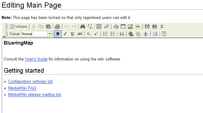

I've tested the fck+mediawiki extenstion on mw 1.11 following the instructions outlined in http://mediawiki.fckeditor.net/index.php/FCKeditor_integration_guide#Download_FCKeditor_extension exactly.
I did not edit the optional file. line numbers can change dramatically between versions.
Note: only the mediawiki.fckeditor.net extension works in mediawiki, the normal fckeditor plug-in will not format the text into wiki text and cannot be installed on media wiki.
It installs fine
