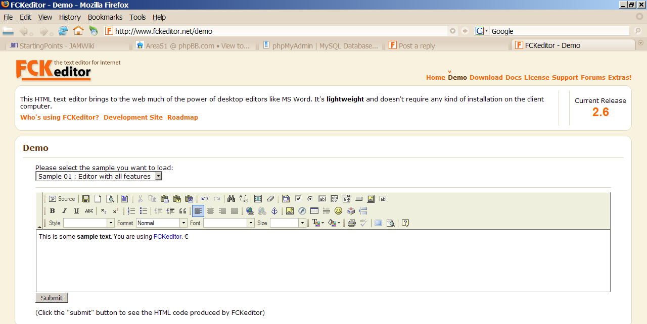

following problem occurs when I have activated HTMLEntities processing in fckconfig.js.
When entering the EURO sign (€) in text-view and switching to source-view it is translated to ¤. Switching back to text-view shows a square instead of the correct sign.
I had a look at the demo of the editor on this site and had a different result. In the demo the sign is translated to &euro when switching to the source-view.
Any suggestions why in my case the sign isn't translated properly would be highly appreciated.
