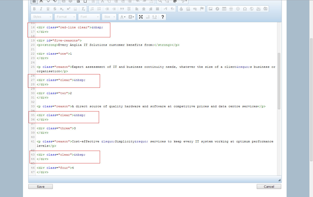

Hi everyone.
Having spent quite some time searching around to stop CKEditor adding into empty <div>'s. I have added the following into ckeditor > config.js but still the is being added...
CKEDITOR.editorConfig = function( config ) {
// Define changes to default configuration here. For example:
// config.language = 'fr';
// config.uiColor = '#AADC6E';
config.fillEmptyBlocks = false;
// Prevent filler node only in float cleaners.
config.fillEmptyBlocks = function( element )
alert('fillEmptyBlocks!');
if ( element.attributes[ 'class' ].indexOf ( 'clear-both' ) != -1 )
return false;
...and as you can see from the attached screen shot, it's still adding the
Any help would be much appreciated.
I do believe that's a
I do believe that's a confirmed bug.
Thanks sebstefanov
Thanks sebstefanov
If I read it right, I need to make a couple of changes to the htmldataprocessor.js file but I dont have that file.
I've done a search for "fillEmptyBlocks" and only the following 2 files contain that string...
ckeditor > ckeditor.js
...without htmldataprocessor.js I feel a bit lost on how to fix the bug.
