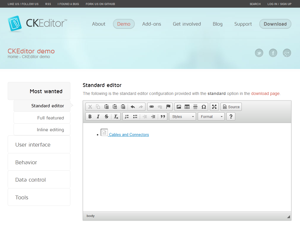

My Customer i is having a problem about wiping out of < i class ...> </i> tags.
The Problem is when we enter an html script containing <i class ..> </i> tags and attributes into the source view tags, mentioned tags are wiped out.
Example HTML Script is entered into source view
<li><a href="#"> <span class="markets-image"> <img alt="" src="/images/about-acal-markets-cables.jpg" /> </span>
<span class="about-markets-text"><i class="about-markets-arwright"></i>Cables and Connectors</span> </a></li>
and what we get is the following text which do not contain <i> tag.
<li><a href="#"><span class="markets-image"><img alt="" src="/images/about-acal-markets-cables.jpg" /> </span> <span class="about-markets-text">Cables and Connectors</span> </a></li>
You may also refer to the attached images taken from tests with your Demo Editor on your website.

If you are using CKEditor 4.1
If you are using CKEditor 4.1, you should adjust your Advanced Content Filter settings. See more information here and in the links mentioned in that release post.
