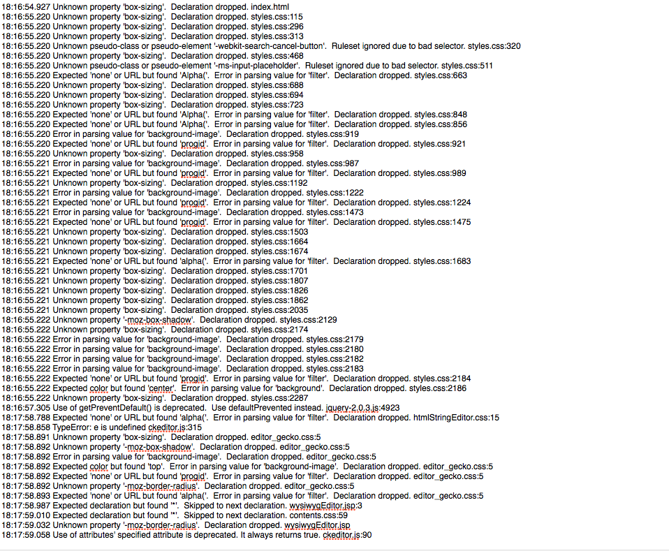

Please note this issue is happening only on Firefox 24 ESR on mac. Other browser and operating system we are not seeing this issue. Could you please let us know is this already bug for FF on Mac or what we are doing wrong? I am attaching the sample javascript console logs for your reference.

Application is in Flex(Flash) and on clicking a button it popups a dialog which loads the jsp page having ckeditor. Some of the javascript function are part of the action script class which opens the dialog and loads the JSP page containing ckeditor. I have commented those statements in my HTML page hence OK and Cancel button will not work. We are using the ckeditor full with version 4.3.3. As I said the work around for this is click the source button in ckeditor and cursor or caret shows up and we are able to type. But again after sometimes the issues reappears.
