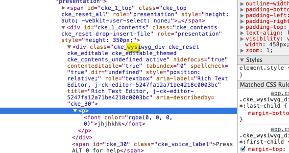

Also found this issue
But only in Div edit mode.
Font tag comes out after i delete a image tag within the contenteditable area.
Check this: http://dev
Check this: http://dev.ckeditor.com/ticket/9998. This is a Webkit/Blink's bug.
