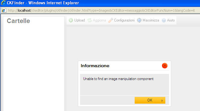

It does not work. From the
It does not work. From the error as in the attached picture. code used

That means that the CKFinder
That means that the CKFinder script hasn't been able to find a component installed on your server to handle images, so you can either disable the resizing of images (as well as thumbnails), or as it's linked at the top of the config.asp file, use the setup script that tries to check your server and suggest you how to configure it to let asp.net do the job.
Check this explanation and download the wizard for CKFinder 2.3.1.
