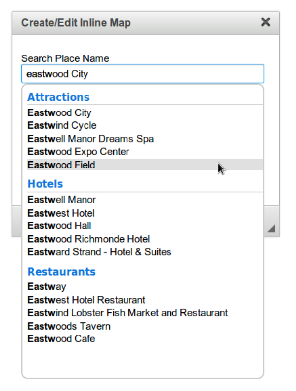

We are using an autocomplete feature in a text input field (like a typeahead search field) in a widget's Dialog window. The problem is, when the user pressed the ENTER key, the OK confirmation button will be triggered. It turned out that the behavior is hardcoded in the Dialog plugin. Ideally, when the user pressed the ENTER key, the OK button should not be triggered automatically, especially when there's a suggestions' list showing in the autocomplete field (see attached).
