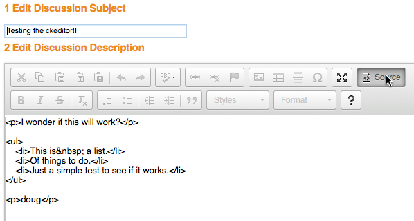

The first screenshot attached is what the editor looks like at my site when editing.
The 2nd screenshot attached shows what the result looks like when viewed after posting (you can see all the extra linespaces.
And I think I can see the cause - if I look at the source (3rd screenshot attached) it looks like there are extra lines in the source.
In fact, if I edit it in "source" mode and delete the extra lines and resubmit the end result looks fine.
I was wondering how to avoid those extra linespaces in the source to begin with.
Any hints would be appreciated. Thanks!

Do I maybe need to set
Do I maybe need to set something like this when invoking the editor?
That seems to help somewhat
That helped somewhat. If I add the above settings I get rid of the extra break before the <ul> tag, but not after. The source now becomes:
<p>Another list:</p>
<ul>
<li>one</li>
<li>two</li>
<li>three</li>
</ul>
<p>doug</p>
