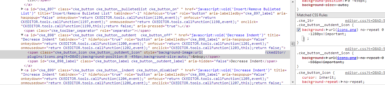

I upgraded from CKeditor 4.2 to 4.2.1. Since I did this, I am having problems with the icons showing correctly. I have even installed a different skin and tried that but it has the same problems. I attached a screenshot that shows the issue.
As you can see the .cke_button__outdent_icon is listed twice. If I unchecked the top one, the bottom one will load and it will look correct. Does anyone know what could be going on here?

I've got to ask this - did you clear the cache? :). Normally CKEditor when upgraded works without problems, because the timestamp (used when loading assets) differs between versions. But in some cases it may happen that you changed e.g. preset or switched between two custom builds (within one version) and then timestamp is not enough.

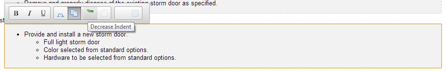

Here is a screenshot of what
Here is a screenshot of what it actually looks like

It appears I originally installed the basic version and when I upgraded I used the standard version. Not sure why but that was my problem. Thanks.
