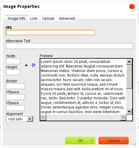

If you look at the demo on the CKeditor home page - the Standard Editor has an image button - you click it an it gives you a popup with three nice tabs - the rightmost of which says "Upload" - which gives the impression that the standard free editor supports image uploads.
I downloaded the full version and when I run the examples I get an editor with an image button - when I click it I get something else - there are no tabs - just the words Image Info Link Advanced where the tabs should be. None of these support image uploading.

To answer your first question, yes, CKEditor needs a file manager. The demo does say it, as well as the download page. If there's any way you think this can be made clearer, let us know. You're not obliged to use CKFinder. Here's more about installing any file manager.

Cosmetics: the Kama skin - maybe this is correct. Can't tell which tab is selected. I'll attach a screen shot from Chrome 31. Tried w IE and safari - same look.
