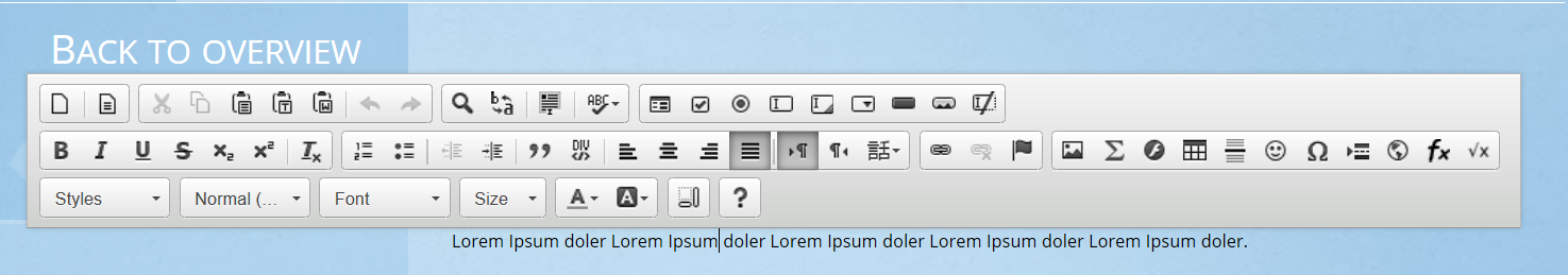

I customized the Full CKEditor 4.3.4. and customized it by adding the Code Editor (PBCK Editor). When I click into the inline editor area, the toolbar shows up. The issue is, that I would expect the pbck editor icon to appear. But, it does not. The issue was - again - I like the toolbar settings, I simply want to append the PBCK editor icon. What puzzles me is that the icons from the other plugins (LATEX, Math editor) are displayed. See uploaded screenshot. Why is that?
So, your example of adding the icon manually when plugins are loaded, is making sense. I just need to find the PBCK editor button's instance name and then invoke
