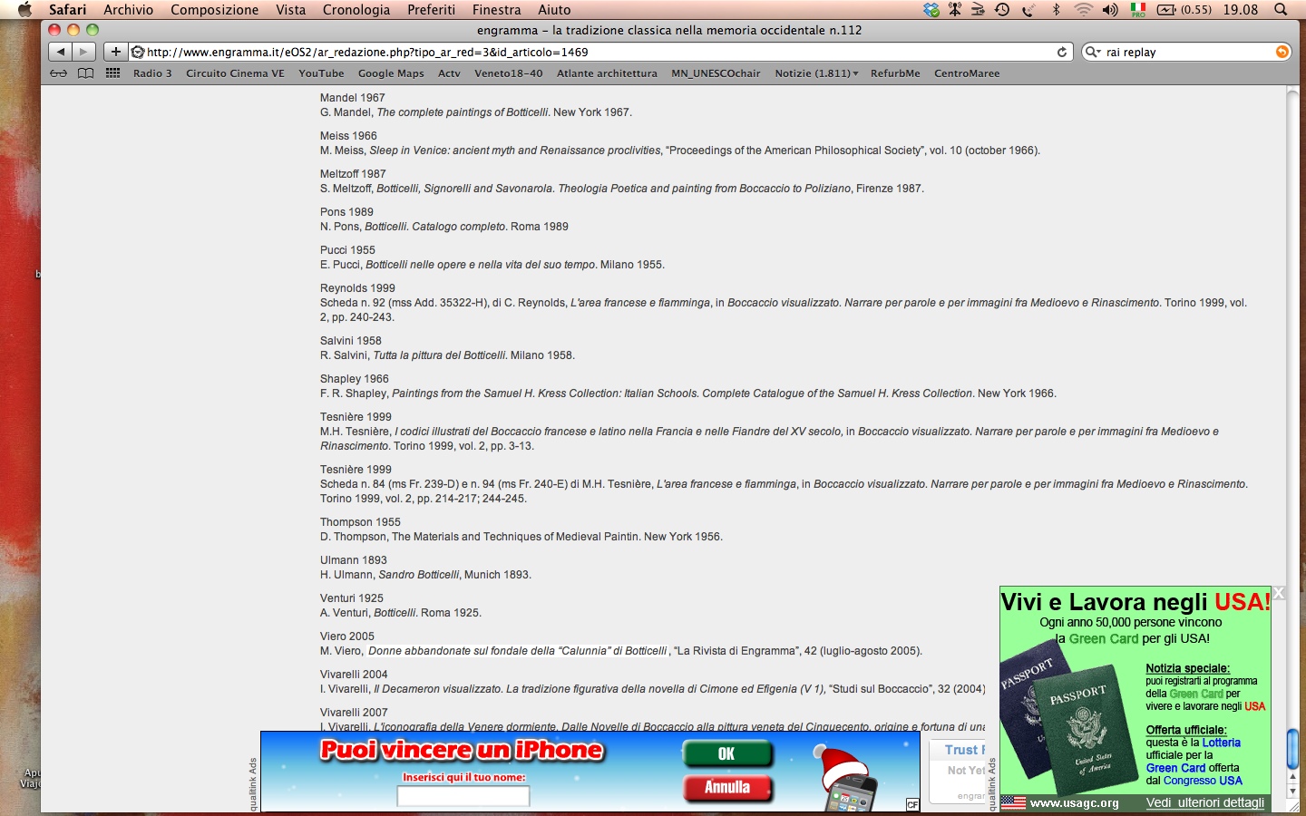

I use CKEditor 3 as an editor for my university scholar journal CMS.
This week some of the editors pointed out that some ads were displaying on our new articles. After further investigation I noticed that some articles had, on the source code, a final hidden textarea that id itself as "adlesse_unifier_magic_element_id". Upon further searching I discovered that, according to other people experiencing the same issue, this was due to a malicous Safari extension (no idea which, I'm not on a Mac) which, once activated, would start adding this code to ALL your form submission. If you search online you'll find that when posting on a forum, you'll get the html stripped and converted, so you actually read the code, but when posting on CKEditor, this will end up covering your website content with ads!
