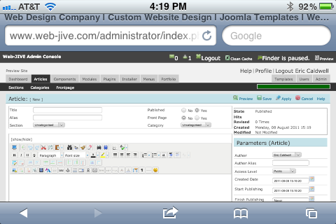

Those are some good questions right now. We are an iOS5 beta site (we have and can grant access to DL and install iOS5). We're prodominantly a web design and development firm and we're looking at our long term WYSIWYG ediotor strategy and part of that stategy was testing TinyMCE and CKEditor and promoting that as our core WYSIWYG with training videos, help, etc.
We use JCE/TinyMCE now but, we're really digging the CKEditor and are trying to figure out which, or both will work on the iOS5 platform, if either truly will because of Apple.

I ran the test and yes, you can edit/type but, my question from day one is will CKEditor support the iOS5 devices with button bars ect. The iPad is the intended audience. Using these toolbars on iPhones would suck.

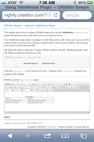

Here are the answers to your questions:
First test: I click on the div, no carat appears.
Second test: I do not understand your test. There is no trackball on any mobile device. Since I cannot make a selection within the div to cause a carat to appear scrolling simply scrolls the entire window.
Third Test: Clicking on the link tries to open it.
Fourth Test: Keyboard does not appear.
Firth Test: As noted above keyboard does not appear, no way to complete this test.
Sixth Test: I do not know what Swiftkey is.
Seventh Test: This is a comparison with Android, I do not have android.

Again, I have an emulator, not an IOS5 device, but they behave very similarly.
Finally I have played with TinyMCE as well, and there is no evidence that it is working there either.
