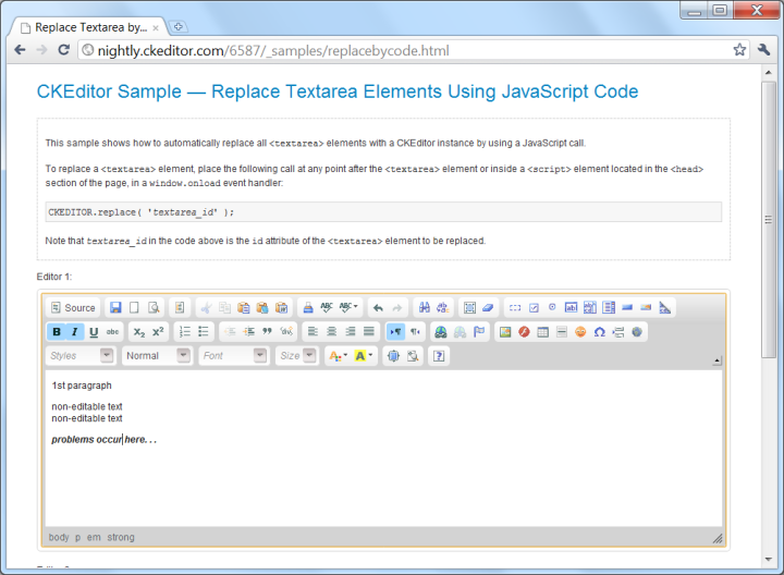

May I know what browser did you use for testing?
as I got same result (wrong icons state with situation stated before) on IE7 and IE8
Re: div contenteditable + p tag = bugs?
so what you are carrying out is that, the icon states problem can solve in nightly version while after switching to the view to source and then back to WYSIWYG mode?
So if i am not going to enable the source view function, I can't solve this problem b4 3.5.3 released?
Or i have to call some functions which work behind the scene when switching the mode from WYSIWYG to Source mode?
I was able to reproduce the problem described by you (the toolbar icons not showing a correct state) when I turned the style on and off using the mouse and switched from WYSIWYG to Source and back. This did NOT work on the demo page for CKEditor 3.5.2.
The same scenario tested on the nightly build worked so I assume the problem that is causing the issue is now fixed and it will work as expected in CKEditor 3.5.3.
As for the purpose of switching from WYSIWYG to Source and back, I just used it to demonstrate the issue.
