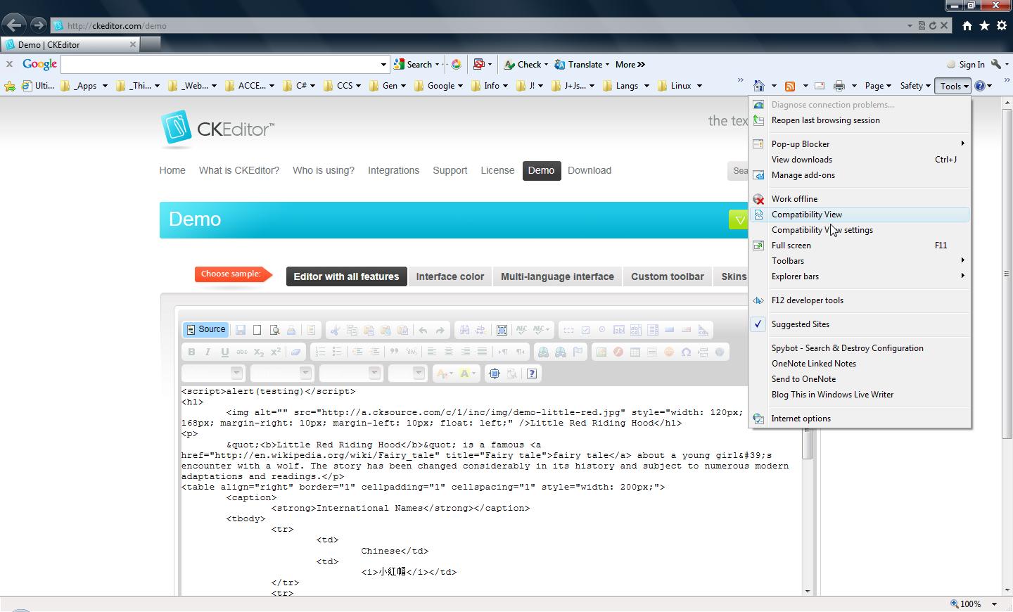

Re: Some Problems With Usage - Example
Here is an example from your demo site showing the IE9 compatibility mode problem in CK source mode.
See the two attachments. It is easily reproduced with any JavaScript tags in CK.
I think compatibility mode will be in use for a while.
I also cannot select all in the source mode from the toolbar in either mode.
There must be some JS issues somewhere that IE compatibility breaks.
