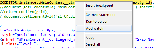

Can you explain how I can correctly check the contents of CKEDITOR.instances. Using IE9 developer tool I was able to drill down to CKEDITOR.instances but I was not 100% sure of what I was looking at.
Re: How to Append Text to Editor
That worked. If anybody has an issue with this
Using IE 9
I added a watch to CKEDITOR
View it instances
FireFox.
The same can be done with Firebug
Thanks again
